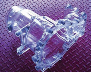

Though typically a casting, this clear plastic transfer case prototype produced by 3-Dimensional Services allowed an axle manufacturer to view oil flow within the prototype.

“Typically this part would be a casting,” Duffie noted, but even with advanced sensors it is tough to see through cast iron. So, to get a better understanding of how the new design actually performed, the producer opted for a clear plastic transfer case prototype. They needed a partner to provide rapid prototyping, molding, and precision machining, and do it quickly.
First, 3-Dimensional used stereolithography (SLA) to create a master pattern. Based on the part’s CAD design, the SLA’s laser beam cured the light-sensitive polymers into the shape of the part. SLA, selective laser sintering (SLS), and metal laminating are three prototyping technologies 3-Dimensional offers. For many applications an SLA prototype is sufficient but for this application a tougher, more resilient prototype was required. So, the SLA master pattern was used to create a silicone tool.
First, the master pattern had to be hand polished to a mirror finish to ensure that the resulting tool, and thus the eventual prototype, would have no surface defects that might impede smooth oil flow or viewing. Polishing involved wet sanding alternating with a painting technique. “The painting technique helps us to identify surface areas that might be suspect, and thus require more attention,” according to Duffie. “Once that tooling was complete, then we closed it all off and poured urethane into it. After 24 hours of cure we pulled the tool apart and we were left with the prototype.”
But first, 24 helicoils had to be inserted in order to attach the transfer case to the rest of the prototype axle, so that realistic cycling tests could be run. The part’s mating surfaces were machined flat on a mill, then pilot holes were drilled into the urethane, and then a tap was run. Into these drilled and tapped holes the helicoils, or threads, were inserted on a CNC vertical milling center. These strong steel threads allow the customer’s engineers to assemble and disassemble the part as many times as necessary. There was no question of the part having to wait for a machine to become available: 3-Dimensional has over 40 CNC machining centers and 75 knee mills and lathes.
“The entire operation took just three weeks,” Duffie said. In that time we provided a tough, clear transfer case prototype in which they could see and study every aspect of oil flow under a variety of conditions.”
