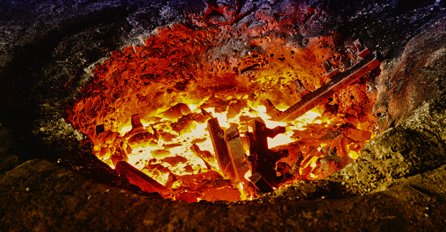

Iron foundries must address and eliminate the effects of oxidation by controlling FeO in slag contacting the molten metal.
Carbon and silicon oxidation losses always occur in iron melting. The losses are costly, but they can be prevented easily with newly available technology.
Free-oxygen atoms present in the molten iron cause oxidation: These unwanted atoms are supplied by iron-oxide molecules contacting the molten metal surface. Oxygen atoms cannot be “removed” effectively from molten iron. Nothing can be done to stop the “oxidation” process once they enter molten iron.
Oxygen atoms seek out and combine with other atoms present in the molten iron, i.e., carbon, silicon, and manganese. They are oxidized according to the Laws of Thermodynamics, which identifies the primary element or elements oxidized according to the existing conditions of the molten bath, based primarily on the molten metal’s temperature.
The secret to stopping oxidation losses is to cut off the supply of free-oxygen atoms. Iron oxide (FeO) contacting the iron surface establishes an equilibrium chemical reaction: FeO = Fe + O. So, stopping the supply of the oxygen atom becomes stopping iron-oxide contact with molten iron. It sounds easy but in fact it’s very difficult, and it has been the basis of Mastermelt’s +20-year project.
