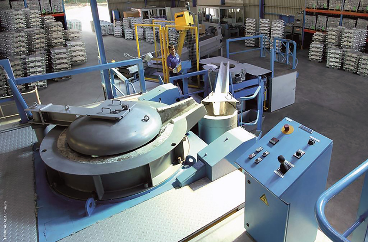

The new system consists of two, 1,000-kg furnaces operating in tandem via a 750-kW Duomelt frequency converter that will distribute power freely between the two furnaces operating in tandem.
The frequency converter will be equipped with  IGBT modules to operate the system with a consistently high power factor (cos phi = 0.99 at the converter input.)
As energy efficiency is important to Lundberg Pressgjuteri, both furnaces have been fitted with an energy-saving coil to increase efficiency by up to 7%, especially when melting aluminum. The JOKS-Touch system with two operator stations is used to control, monitor, and document the melting process automatically.
