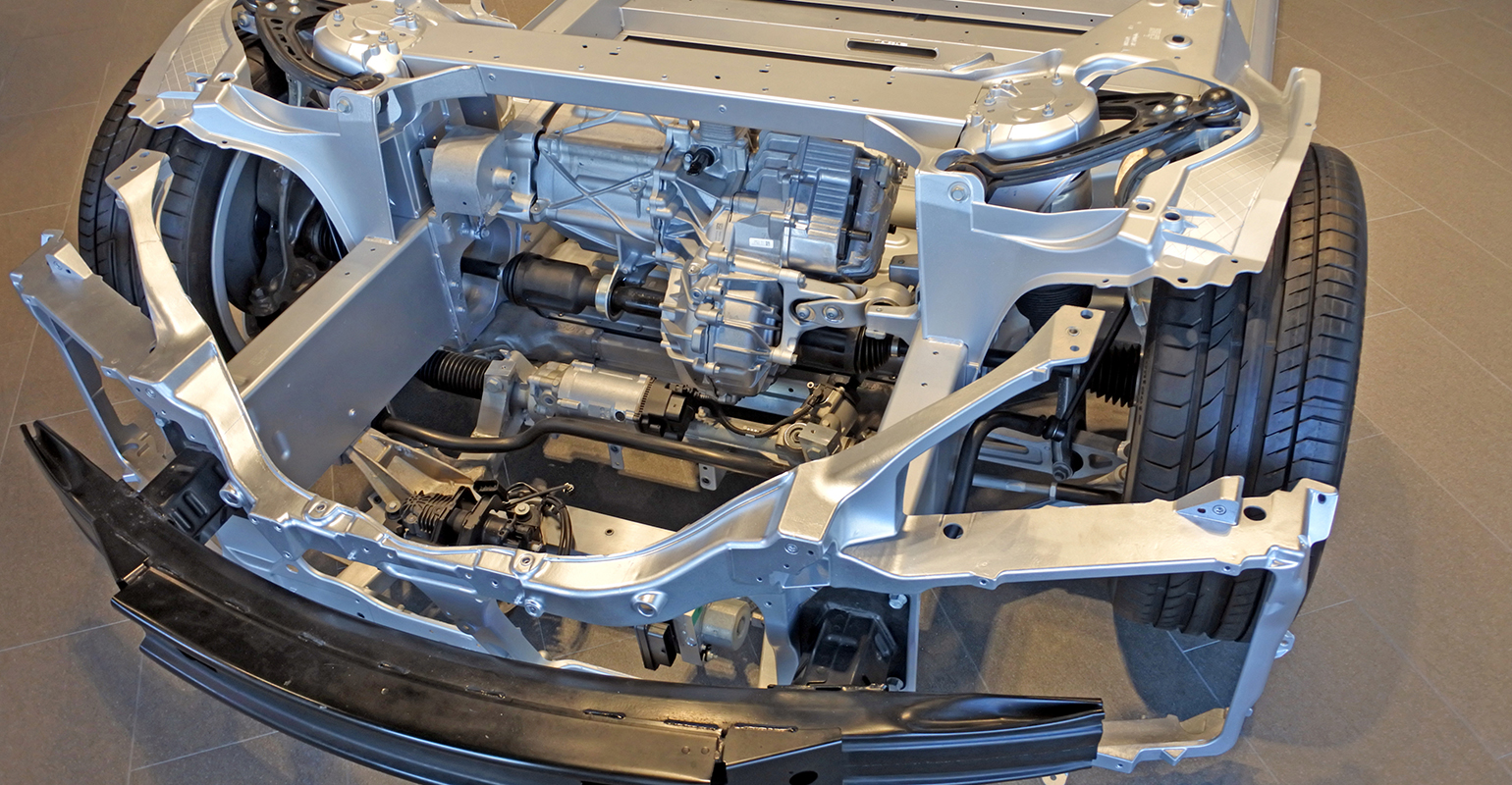

Larger, multi-functional cast parts. Concerning automobile manufacturing, in recent years we have seen fairly significant developments in metal processing and the overall assembly process. Examples are the rapid shift from steel to aluminum body panels, and the creation of closed-loop systems in which alloys can be recycled and repurposed for a consistent application, almost infinitely. The drivers here are not new: weight savings result in higher fuel efficiency, cost effective alloys can lower cost and recyclable materials can reduce carbon footprint.
Likewise, automotive designers’ shift toward larger structural cast parts is not prompted by new change drivers but is resulting in benefits to new vehicles. One primary driver is the determination to reduce the total number of parts needed for vehicle assembly and the simplification and cost reduction this can generate. In the case described here, over 70 parts were eliminated from the overall assembly.
Another driver is the ability to combine a vehicle’s structural requirements with its power plant so that the battery adds structural rigidity to the frame, improving overall safety and ride characteristics and lowering the center of mass. Advances like these require the entire supply chain to reimagine the way cars are made and to develop new products and processes that enable these benefits to be achieved.
