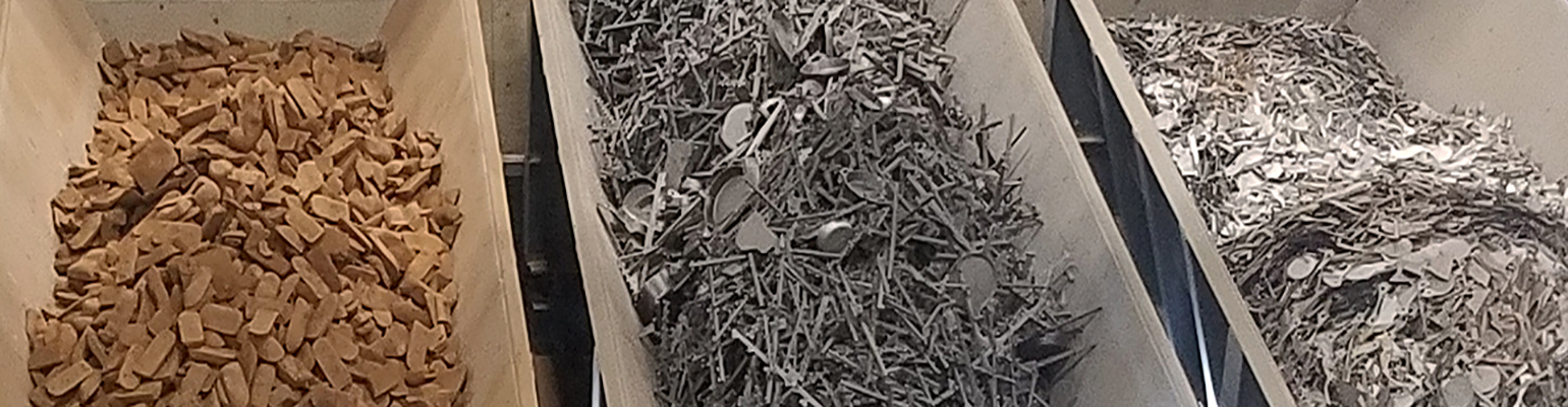

Foundries typically store different scrap materials like steel, pig iron and returns in separate storage areas or ‘bins’ that are easily accessible for refills from delivery trucks. The batch-making process involves transferring charge materials from storage bins onto a conveyor using a crane. During this loading, the conveyor rests on a weigh frame that keeps track of the total amount of scrap that has been added.
For example, if the conveyor had five piles of scrap front to back, each pile or section would be considered a zone. The crane delivers additional ‘steel’ material to be placed on the pan, specifically on the steel pile at the front, or Zone 1. The crane operator follows instructions (a “recipe”) detailing the type of metal and where to place it in the pan. Each pile on the conveyor is one ingredient of the recipe.
There is a difference between a scrap metal ‘material’ and an ‘ingredient.’ Material is simply scrap metal of a certain type and is only one attribute needed to fully define an ingredient. In addition to the type of material, the crane operator needs to know the required amount, the location on the pan or the ‘zone’ where that amount is placed, and the order in which the ingredients are to be added. For instance, of five piles on the pan, two are made up of steel and two are pig iron. Despite having common materials, these piles are distinct ingredients because they are placed in different zones.
Specifying zones in a recipe is important because it enforces a favorable ‘layering’ of scrap metal when it is charged into the furnace. The ingredient in zone one will impact the refractory of the empty furnace in a batch-melting operation. To prolong the life of the furnace refractory, it is advantageous to place soft, springy scrap in the front of the conveyor, followed by dense easy-to-melt scrap such as pig-iron.
On the other hand, returns that contain large, intertwined, irregularly shaped pieces, usually are placed in the back and when they are charged into the furnace there is already a molten bath to receive them.
