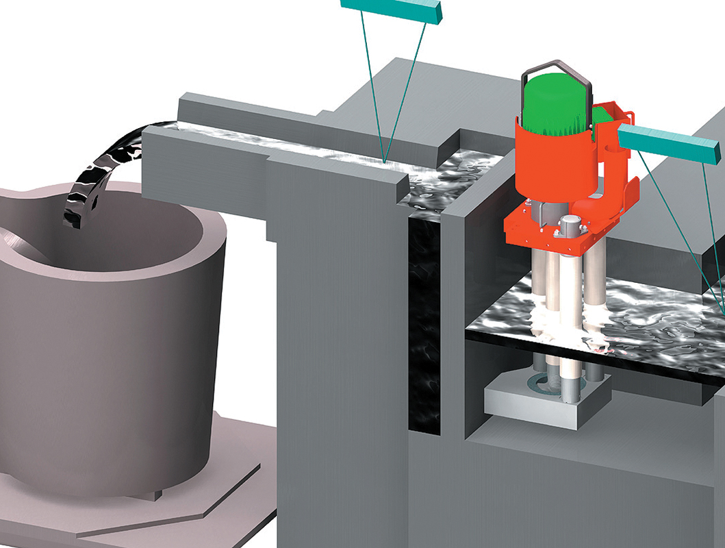

A new way to do it. Here is an example of rethinking the use of existing mechanical pump technology created a new way to transfer molten metal and alleviate all the associated pain. Normal operation would see molten aluminum alloy (A-380) transferred by an MMEI Mini Launder transfer pump into ladles and then transported to the casting machines. The process was continuous and designed for high efficiency, and thus the metal level in the furnace was never allowed below 20 inches to keep the pump fully submerged.
Periodically, however, the furnace needed to be emptied to allow for routine maintenance or to switch alloys. The existing process was to use gravity, tap out plugs, and sow molds to manage the emptying process. This raised safety concerns for the operators as they were forced to be in the path of the molten aluminum. It might take them several days to empty the remaining 20 inches of molten alloy from a 50,000-lb. furnace, halting production and requiring more than 50 molds to handle the metal drained from the furnace – more than the plant had available, making it necessary to wait as metal cooled and solidified and removed. Clearly a very painful situation, and one that kept scarce labor resources focused on something that was of limited value to the organization.
They needed to avoid emptying into molds, and to get the remaining 20 inches of metal into ladles and into the production flow. This was the opportunity for the new MMEI Raptor Transfer Pump, which is completely portable, quickly submersible, with a variable-speed motor capable of moving 1,100 lbs./minute. It pumps metal out of the furnace down to a level of 5 inches or less, putting all that metal into production. Then, the remaining 5 inches was drained via gravity quickly and easily, leaving the furnace completely empty and ready for maintenance to begin. This solution resolved the safety issue, kept production at normal levels, significantly increased the efficiency of the furnace emptying process (from days to hours), and generated a strong financial return for the metalcaster.
