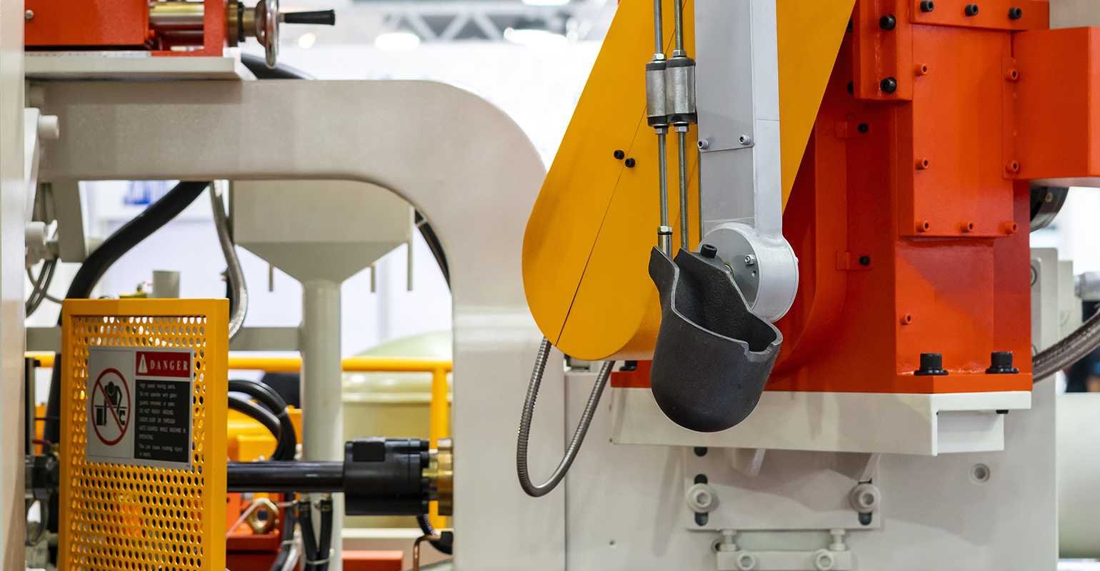

Close up, ladle and mechanical arm of a high-pressure aluminum diecasting machine.
