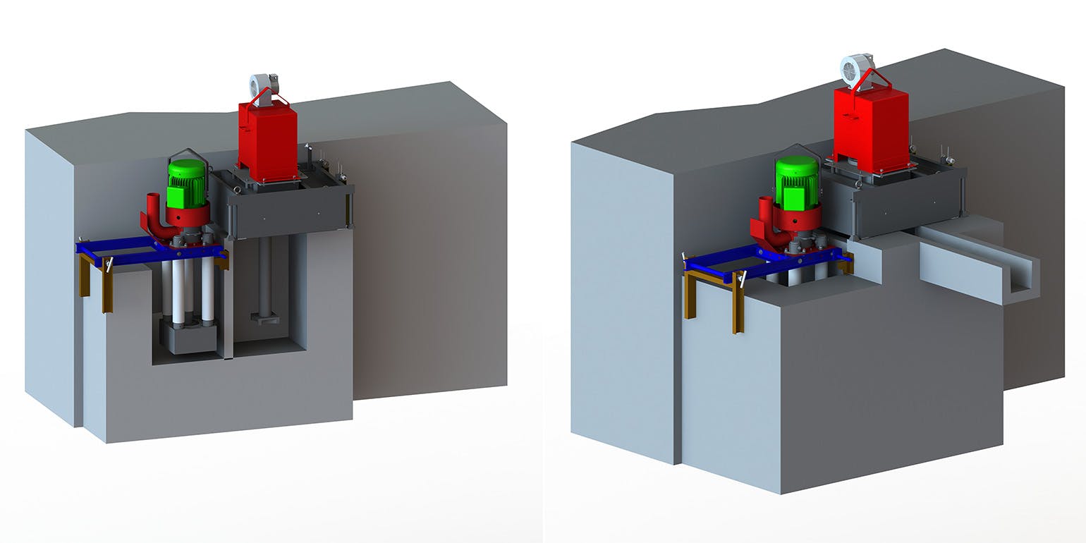

We have addressed this issue as part of our filtered launder-transfer system so that contaminants are filtered out of the process, effectively eliminating the root cause early in the process. By filtering the metal using ceramic foam filters that can be selected based on alloy qualities and the potential contaminants, we can be sure that we are sending clean metal downstream to the casting machine.

By using a launder transfer pump so that metal is transferred in a subsurface manner we can avoid the likelihood of oxidation, which will promote downstream metal quality and minimize metal loss. Combining a filter with the launder transfer pump, and then a well-designed launder that virtually eliminates oxidation, we can see how each step of the process becomes equally important for delivering clean metal to the mold and avoiding compounding problems.

In cases of filtered launder transfer, it may be necessary to raise the metal level to accomplish the transfer in the way that’s most conducive to quality metal and productivity. Likewise, the volume of metal to be transferred and how to maximize it while preserving the benefits of filtered metal is another detail highlighting the advantages of experience with molten metal transfer system design and installation.
