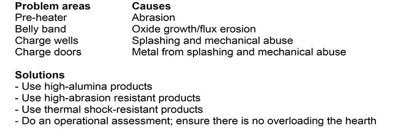

Wet-bath reverberatory melters
Wet-bath melters, high head-room, or radiant-roof low-headroom melters have similar issues. Both types of units should have a preheat hearth at one end and a clean-out door at the other. The hearth, which can be used to preheat sows or ingots, will take some abuse over time. (NB: Do not cast the entire hearth with high-abrasion material.) Cast only the load-bearing areas with the more expensive, high-abrasion material.)
The belly band area – where the molten metal makes contact with oxygen – is where abrasion will take place on the sidewalls – especially if you are over fluxing with an oxide-removing flux.
Charge wells and doors must be cleaned daily, as the splashed-up metal should be removed as soon as possible to avoid a massive build-up. Scrape it off quickly into the bath and reuse it. The well should have the same refractory material as the inside walls below the metal line. Arch openings must be checked weekly to ensure they are not getting build-up that would decrease the square inches of the opening.

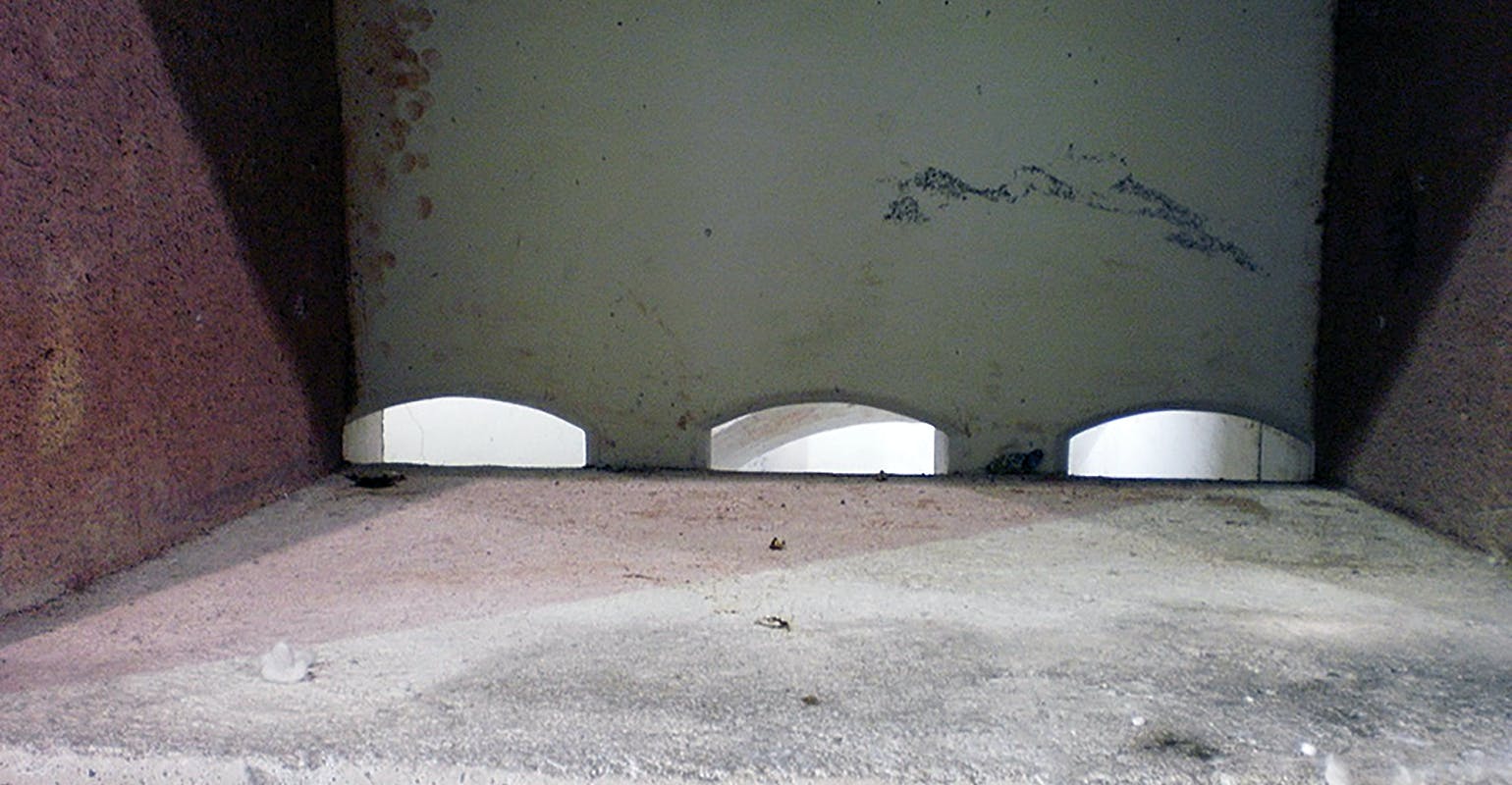

Dry hearth furnaces
The dry hearth is where most of the abuse will occur. Care should be taken to know exactly how much metal to place on that hearth at one time. The hot modulus of rupture for the refractory material should be taken into consideration when choosing this refractory. This will let you know the load or the refractory (psi lb. f/in2) can manage when hot. Always remove any dross on the hearth after melting before loading the next ingots or sows.
The divider wall is the hardest wall to clean in the furnace. This wall separates the melt zone (hearth) from the hold zone. You can clean the hold zone side pretty easily, but the dry hearth side is difficult unless there is an extra door on the side of the dry hearth to facilitate cleaning.
The openings in the divider wall should be sized so that no scrap or ingots can fall through them. A special tool should be designed to clean those openings, as any stuck metal that passes through them needs to be cleaned off on a daily basis. And never load the hearth to the point that ingots or sows are up against the divider wall.
Refractory should have SS needles in it to help hold the wall together. Some companies use structural tubing in the wall to air cool it and to add stability to the wall. Usually, the wall is only tied into the floor and sidewalls, which means it is the least stable wall in the furnace. Some manufacturers use a floating roof design which prohibits tying it into the roof, or they leave an opening at the top of the wall for the products of combustion to be exhausted through that flue.
