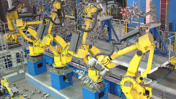

The new Aeration Molding Robotpouring (AMR) production line addresses automotive customers’ demand for lighter parts, according to GF Automotive. It has a capacity of up to 60,000 metric tons/year of ductile iron parts, including parts that the operator describes as “exceptionally fine-featured, and thus lightweight.”
The AMR line has 20 robots pouring ductile iron, reducing the labor requirements, and also sets “a benchmark in terms of energy efficiency,” the foundry operator stated. A built-in heat-recovery system converts waste heat to warm the plant, and state-of-the-art electro motors are used to cut energy consumption by over 40%.
