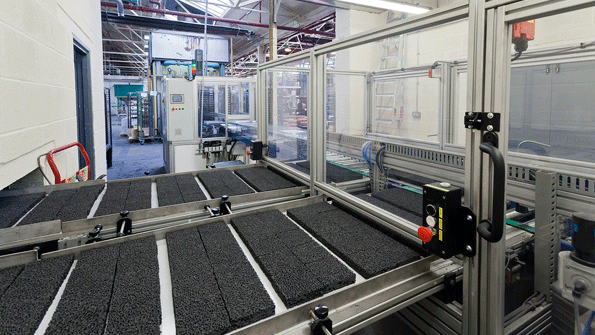

Foseco, manufacturers of a variety of metalcasting consumables, reported it recently completed “a major expansion” of production capacity for STELEX PrO brand of carbon-bonded filters at its plant in Tamworth, England.
Carl Woolley, operations manager at the Tamworth operation, noted that the 18-month project completed earlier this year effectively doubled production capacity there. “This highly efficient kilning process uses dramatically less energy, resulting in reduced greenhouse gas production,” Woolley said. “Product quality and consistency are also improved.”
