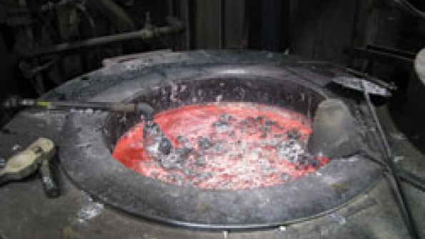

In-plant aluminum dross recovery has been available for some time, but isn’t widely used for small volumes of dross. Crucible melting furnaces typically generate 5-25 lb of dross, and most recovery equipment has been considered too cumbersome to move from furnace to furnace.
Many crucible melters stage an empty barrel next to the furnaces as a convenient receptacle for the dross and skims that are the natural products of melting ingot, home returns of gates and risers, and any process degassing or cleansing operations performed on the melt before casting. The volume of dross generated varies with the charge, but melting losses of 3-8% are common with smaller crucible furnaces.
With the rising cost of alloys, most operations try to reduce the metal content of the drosses they send for recycling. Usually, this involves mixing fluxes with the drosses on the melt surface, manually working the mixtures to separate oxides and dirt from good metal, and then skimming the resulting mix into the barrel. The task is somewhat obnoxious in that many of the fluxes generate smoke and fumes, and require labor and lost furnace time while cleaning is underway. In spite of these efforts, processed drosses still contain approximately 50% of good alloy, while unprocessed skims and drosses being removed from the crucible furnaces may contain as much as 85-90% good alloy. These co-products of melting are typically removed by local agents for a small portion of the true value of the material.
