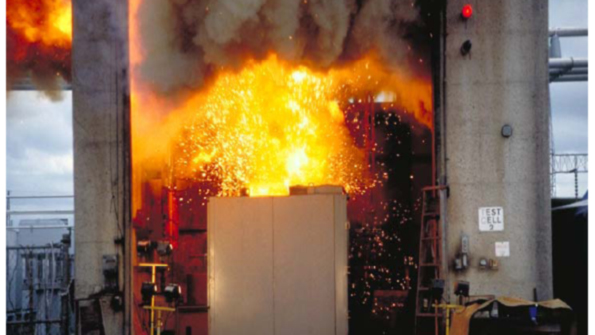

An arc flash results when an electrical fault generates an arc ionizing the air and causing combustion Reportedly it is the most frequent electrical accident in workplaces and may cause burns andor other injuries

The federal Occupational Safety and Health Administration (OSHA) cited Pure Power Technologies LLC with eight safety violations following an incident last June 25 at that group’s ductile iron/CGI foundry in Waukesha, WI. A maintenance supervisor endured severe burns from an electric arc flash while servicing a 480-volt circuit breaker without proper electrical protective equipment.

An arc flash results from an electrical fault that generates an arc, ionizing the air and causing combustion. Reportedly, arc flash is the most frequent electrical accident in workplaces, and may cause burns or other injuries due to the explosion (e.g., shrapnel, pressure waves, electric shock.
The usual causes of arc flash may be mechanical (accidental touching, dropping metal tools or parts, faulted lines, loose connections), environmental (water, dust, impurities, or corrosion at contact surfaces), or failure of insulating materials.
