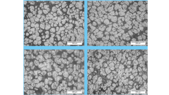

Examples of SSM microstructure achieved during test runs of the Ajax Tocco Magnethermic semisolid casting process

In the ATM SSM process, a measured amount of molten aluminum alloy is transferred from the source to the ATM processor.  Molten metal is cooled quickly through the liquidus temperature phase, to the semi-solid range.  Metal is stirred as it is cooled, resulting in a homogeneous mass. Primary aluminum particles nucleate in the molten charge as metal cools through the liquidus temperature of the alloy.
As the particles cool and grow, they become spherical from the shearing action. The freezing of the alloy typically results in dendritic structure. As the semi-solid material cools to a predetermined consistency, the charge is transferred to the casting machine when desired condition of material is reached.
In the results of test cited by ATM, over 40,000 castings made with the SSM system, with no mechanical shutdowns or operating failures. The tensile results with 380 aluminum alloy slurry exceeded 3.5% elongation, with some runs at over 4%. Standard diecastings were tested at 1.5% or less typ.
