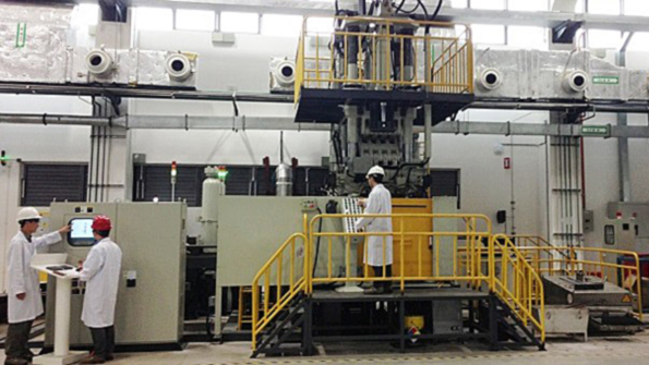

GM research teams in the US and China worked with a Chinese machine builder to develop the Vertical Squeeze Casting Machine it is now using to produce magnesium auto parts at the GM China Advanced Technical Center ATC in Shanghai

General Motors Corporation’s GM China Advanced Technical Center (ATC) in Shanghai has started operating a new squeeze casting machine it developed. GM described the machine as “the first in the world” for “next-generation” magnesium castings.
Squeeze casting uses a pre-heated, two-part die that is filled with molten metal. Once the metal begins to solidify in one half of the die, the other half of the die is used to apply pressure while solidification proceeds. GM stated its new machine is a breakthrough in its lightweight materials research.
The Vertical Squeeze Casting (VSC) machine is installed at the 65,000-square meter research center that brings together several GM technical and design organization. GM stated its VSC machine was designed jointly by lightweight materials research teams in Detroit and Shanghai, and was built in collaboration with an unnamed Chinese equipment builder.
The production volume, product dimensions, and other capabilities of the machine were not described. GM stated only that squeeze casting technology would improve its products’ integrity by applying high squeeze pressure during the casting process.
Minimizing Inclusions in Magnesium
The design includes a fully enclosed, magnesium melting and transferring system that can improve casting quality and performance significantly, by isolating the molten metal from atmosphere, minimizing the potential for inclusions.
