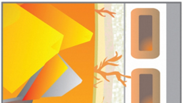

The physics of electrical induction requires the refractory lining between the induction coils and the bath to be as thin as possible. At the same time, it must be thick enough to fully protect the coils and prevent metal run-out during attacks by molten metal, chemical agents, and mechanical shocks.
Metal run-out ranks among the most severe accidents that can occur during melting and holding operations. Runouts occur when molten metal breaks through the furnace lining. If cooling, electrical, hydraulic or control lines become damaged, there is danger of a fire or water/molten metal explosion. Maintaining furnace lining integrity is key to preventing a run-out. Such integrity can be compromised by:

In induction furnaces, refractory linings and crucibles are subject to regular wear from the scraping of metal on the furnace walls, largely because of the induction stirring action caused by the furnace’s electromagnetic field. In theory, refractory wear should be uniform, but in practice this never occurs. The most intense wear occurs:
• At the slag/metal interface;
• Where sidewalls join the floor; and,
• At thin spots caused by poor lining installation.
The entire furnace should be visually inspected whenever it is emptied. Special attention should be paid to the high wear areas described above. Observations should be logged.
Although useful, visual inspections are not always possible. Nor can inspection alone reveal all potential wear problems. Some critical wear areas, such as the inductor of a channel furnace, remain covered with molten metal between relinings. Also, low density refractory areas can escape notice. These limitations make lining-wear monitoring programs essential. Follow your refractory manufacturer’s instructions for lining inspection and maintenance.
