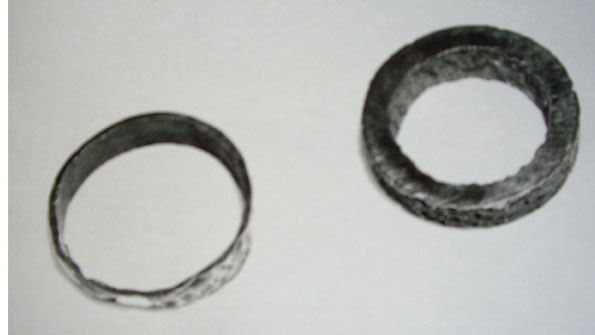

Figure 1 Ring samples of the original cast steel left and steel processed by an electric field right

To determine the efficiency of processing of liquid alloys by electric field, experiments on cast steel with carbon content of 0.4% were conducted. Processing was done with wolfram electrodes immersed into the steel melt under the following conditions: current density 0.970 A/cm2, processing time 60 sec. This regimen was chosen using practically obtained dependencies of the increment of the tensile strength ΔσB=16[1–exp(-5.08i)] and the increment of limit value of fluidity of alloy  ΔσT=11[1–exp(-3.96i)], where i is current density.
In the process of measuring of the influence of the electric field on the crystallization process, special cone copper molds were used, with a height of 60 mm, upper diameter of 40 mm, and lower diameter of 30 mm. Steel was produced in an induction furnace with a volume 160 kg, with a refractory lining, and under temperature (1,500±10)°C it was transfused in two casting ladles of volume 40 kg. The steel melt was kept in ladles for 60 seconds, and one of them was under an influence of electric field.
Then, both kinds of steel were poured into two metal forms, where after a three-second delay there was “freezing” of steel crystals on the walls of the forms. After that the liquid residue steel was poured from forms into a mold. The crystal steel castings thus obtained were removed from the metal molds, and 10-mm high ring samples were cut out at a distance of 20 mm from the bottom of castings. These ring samples are shown in Figure 1.
Measurements of the thickness of samples of “frozen” steel crystals showed that on the samples processed by electric field the thickness is larger than on the samples of initial steel. The difference between these values obtained using 27 experiments, on average, occurred to be equal to 6.70 mm. These results prove that the energy of crystal elements of steel is essentially decreased and the number of centers of crystallization in a volume unit of liquid steel is increased after processing by electric field. The increase in the number of crystallization centers results in increasing of the number of equiax crystals, which appear on the first stage of crystallization under a contact with metal walls of forms. These changes in the parameters of the crystallization process lead to increases in the thickness of the ring samples of the processed steel.
