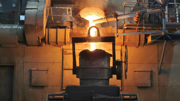

Three 20mt induction furnaces replaced three 135mt melters expanding production with precise attention to the details of the Michigan foundryrsquos ongoing operations

Betz Industries realized it needed to replace its three induction melters, identical 13.5-mt open-frame furnaces in service at the Grand Rapids, MI, gray and ductile iron foundry for more than 35 years.
Each of the three new furnaces has its own 8-MW power supply system.

Inductotherm Corp., noted for expertise in induction melting, heating, holding, and pouring systems was identified and selected to redesign the Betz Industries melting operation, doubling the melting capacity with three new, 20-MT steel frame furnaces, each one with its own 8-MW VIP® Power-Trak® power supply system. In 2011, after much planning and evaluation, the replacement process began.
The installation process stretched over that year. Moorhead explained that the new design required the existing buildings to be enlarged to accommodate the larger furnaces. “We wanted the vault (where the power supplies sit) and the deck to have ample room,” he continued.
“We had to do this in two phases because we had to make sure we were still melting with the old furnaces,” Moorhead recalled. “So, by the end of that year we had furnaces No.1 and No.2 installed, and then we ran those in tandem with our old furnaces.”
That arrangement, with the last of the original furnaces still available, continued for four or five months into 2012. By the end of 2012, the third Inductotherm furnace was in place.
Tornado extraction hoods maximize emissions collection, and pit guards increase workplace safety near the furnaces.
“Everything was new,” Moorhead reported. “The ladles remained, because we use large ladles and transport them to the mold, so those didn’t change. But, the whole alloying system was integrated, so there were controls installed for all of that. So, the operator calls for a recipe of whatever metal at whatever weight and it automatically sends a signal to the crane operator to weigh up an amount of steel and pig iron, and behind the scenes it automatically weighs up all the other alloys – carbon, silicon, manganese, sulfur … that was all automated.”
A new spectrometer system was installed in the control room, so metal quality can be checked before and after tapping, with speedy results that maintain quality while promoting higher production volumes.
Since the installation, the three 8-MW VIP® induction power supplies have been operating “with practically zero downtime,” according to Inductotherm’s Michael Nutt. With the most advanced coreless induction technology state-of-the-art EZ control systems and Meltminder® management systems, “Betz Industries has had no issues with getting the power they needed to keep up with their production schedule.”
The foundry working environment is improved, too, because each furnace is equipped with a Tornado extraction hood that maximizes emissions collection, and pit guards that increase workplace safety near the furnaces. Inductotherm’s advanced lining push-out systems also sped up the lining removal, immediately enhancing melt rates and increasing production.
