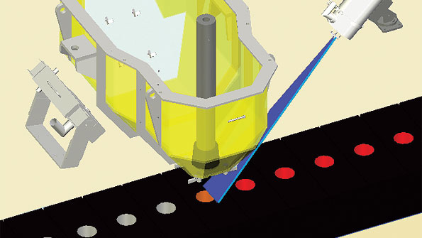

Because the 3D laser projects a line across the entire cup the camera is able to collect level data from both sides of the pour stream to provide more accurate information to the control system

The 3D Laser System uses a line laser together with a custom camera.  The line laser is placed on one side of the pour cup, aimed to project a blue laser line across the cup.  On the opposite side, the 3D sensor picks up the image of the line, as it reflects in the metal surface.  The sensor views the cup at an angle, and can determine the metal level in the cup by reading the position of the line.
For vertically parted molding lines, the traditional spot laser systems require a modification of the pour cup to provide an area for the laser to "see" the metal level while still keeping the cup size small.  But, because the 3D Laser projects a line across the entire cup the camera is able to collect level data from both sides of the pour stream to provide more accurate information to the pourTECH control system, allowing it to optimize its pouring control decisions without the addition of the special laser area.

With its blue light source, the 3D Laser System is completely insensitive to the light from the iron (thanks to the difference in wave length) and because the line laser and 3D camera are on opposite sides of the iron stream, the sensor will see a break in the laser line where the stream enters the cup, making it possible for the sensor to ignore that part of the reading.  This makes the 3D Laser System insensitive to variations in the iron stream (side-to-side movement and fanning of the stream).  As long as the 3D Sensor can see a small portion of the line, the system can continue to operate – even with severely fanning iron streams.
In addition to the 3D camera, the device opposite the line laser houses a traditional point laser that is used to position the pouring vessel over the mold on vertical molding lines, or to perform a cup check on flask lines, verifying the flask has both sand and a cup before pouring starts.  While a traditional vision system often requires additional equipment and mold features to locate the cup (lights and mold notches, as it is difficult to see a black hole in black sand), the 3D lasers point laser uses a combination of an active light source and simple triangulation to locate the cup.
