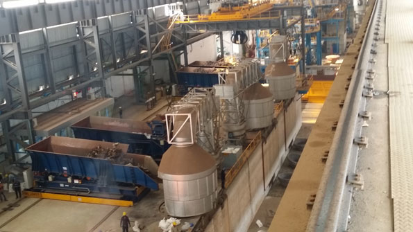

50-mt induction furnaces were the steelmaker’s choice for producing a large volumes of metal with greatest efficiency, to supply a five-strand billet caster.
“Our “Global Yet Local” strategy was laid out at BSRM since our first 7 MW installation in 2005 to this most recent system. It has been a pleasure supporting them as they continue to grow their business,” stated Satyen Prabhu, group vice president, Inductotherm Group.
“We have taken up the challenge of producing a large quantity of steel most efficiently through the induction furnace route and therefore, decided to go for the 50-metric ton furnaces. We ended up commissioning the world’s largest plant for billet making through induction furnaces, which has been possible due to technical leadership, partnership and commitment from Inductotherm Group,” explained Aameir Alihussain, managing director.
BSRM also chose Inductotherm to design and build a system for coating rolled products with fusion-bonded epoxy.

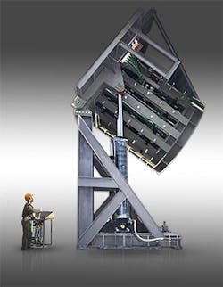

22,000-kW, 50-mt furnaces — The installed capacity of the new melt shop is close to 900,000 metric tons annually. It consists of four 22,000 kW VIP® induction power supplies, each one powering a 50-metric ton furnace. The combination of equipment makes it the world’s largest steel plant operating induction furnaces.
The selection of induction melting technology allows BSRM to increase its overall productivity and efficiency, which is important in a low-margin and competitive industrial segment like the global steel market. In addition, the new melting furnaces will minimize operating costs and reduce particulate and noise pollution. It is more proof that melting steel using induction furnaces, ladle refining furnaces and continuous casters is commercially viable in terms of quality and cost to supply rolling mills and producing commercial-grade steel rebar, wire rod, pipe, and light and small sections.
