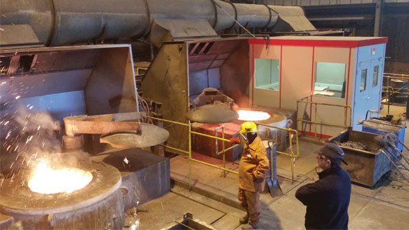

“The three existing furnaces from Inductotherm were very reliable and there was nothing wrong with them,” he emphasized. “They had been well maintained and serviced but they were only giving us 4 metric tons/hour and our plan was to expand to 6 metric tons/hour. The problem was that we are growing at such a rate that we just could not afford to lose any planned production days, so whatever we did had to take place during our autumn (2014) shutdown period.”
Working with the supplier, Thomas Dudley opted to increase the existing, 2,500-kW Power-Trak® single-output induction power source to a 3.5-MW Dual-Trak® system, and integrate that new power supply with the existing 4-mt/hr. furnaces. The installation also would include a new transformer, cooling, hydraulic, and control systems.
The whole project involved moving existing equipment to perform as the backup and excavating the melting area, as an additional 10 to 12 feet of space was needed to accommodate the larger equipment. The control room is below floor level, so much of the work was undertaken by several contractors in a confined space.

The only realistic way to achieve the requested schedule for installation and commissioning during the one-week autumn shutdown was to pull four to five weeks from the project. Thomas Dudley had to undertake a huge civil engineering project earlier in the year while the foundry was still in full production by expanding into the existing scrap bay, to acquire the extra space needed for the revamped operation. They built new, oak-lined scrap bays, replaced flooring to accommodate charging cars, and installed water cooling and pipework.
Inductotherm worked with Thomas Dudley to ensure everything was in place for the October shutdown deadline. “We undertook the project in phases,” said Craig Holdback. “On June 16 the radiator was delivered and we had to crane that in over the roof of the foundry. In July the rectifier/invertor panels of Dual-Trak were delivered with pump set hydraulics, etc., to enable much of the piping and wiring to be done.
“In September we installed the transformer, so more wiring could be carried out,” he continued. “Then came the October shutdown week, which we had all been working toward.
“The foundry closed on Thursday night and we had to wait several hours for the furnaces to cool down before we started work at 6 a.m. on the Friday morning,” Holdback recalled. “The existing, holding VIP was removed and the existing 2,500-kW VIP was repositioned and installed to run one 4-mt furnace. Then, the new 3500-kW Dual-Trak was installed and commissioned. The metal was being poured a week later, on November 2. It really was a testament to teamwork and dedication from all concerned.”

“If we buy the power in the future we can install another Dual-Trak,” Cramphorn said. “You have to remember that 20% of our downtime was caused by waiting for metal – this is virtually eradicated now. We are now getting around 5.6 to 5.8 mt/hr. out of the new plant and are working an extended day shift. Metal is still our biggest issue, but now we are equipped to pursue the market opportunities as we continue to expand.”
