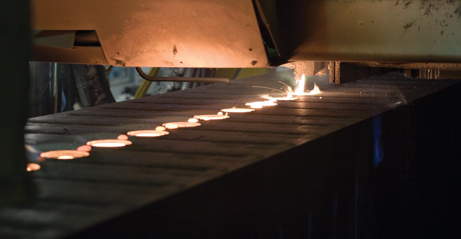

Pouring … the acme of automation
To keep pace with the high speed of vertical molding, more foundries have adopted automated pouring, along with techniques like pouring two molds simultaneously (known as “double index pouring”). Automated pattern changes increase efficiency further, but then manually repositioning the pouring device after a pattern change may create a bottleneck.
Fully synchronizing pouring and molding – seamless pouring  is the answer and is particularly valuable for foundries challenged by multiple shorter runs. Coordinating both functions in all possible situations requires deep M2M integration and, again, the key is to know exactly where each mold is all the time. That lets the pouring unit calculate where and when to pour the next mold and, if required, adjust the pouring device’s position accordingly.
This is relatively simple during steady production. The mold string moves forward by the same distance after each pour – the mold thickness – and the pouring device stays in the same position. Compensating for any minor variation in mold thickness requires only small adjustments.
But for vertical molding, when the pattern changes, so does mold thickness. That’s because the DISAMATIC process varies mold thickness to keep the sand-to-iron ratio constant and account for the pattern heights. That enhances quality and minimizes resource consumption. But after a pattern change, the molding line will be producing one mold thickness while the pouring unit is filling another.
During the transition period, the automated system must adjust the pouring position each time it pours the remaining molds from the previous pattern. If the new molds are thicker, the molding machine will occasionally have to wait while two molds are poured. If the new molds are thinner, the pouring unit also must be able to skip pouring for one molding cycle.
