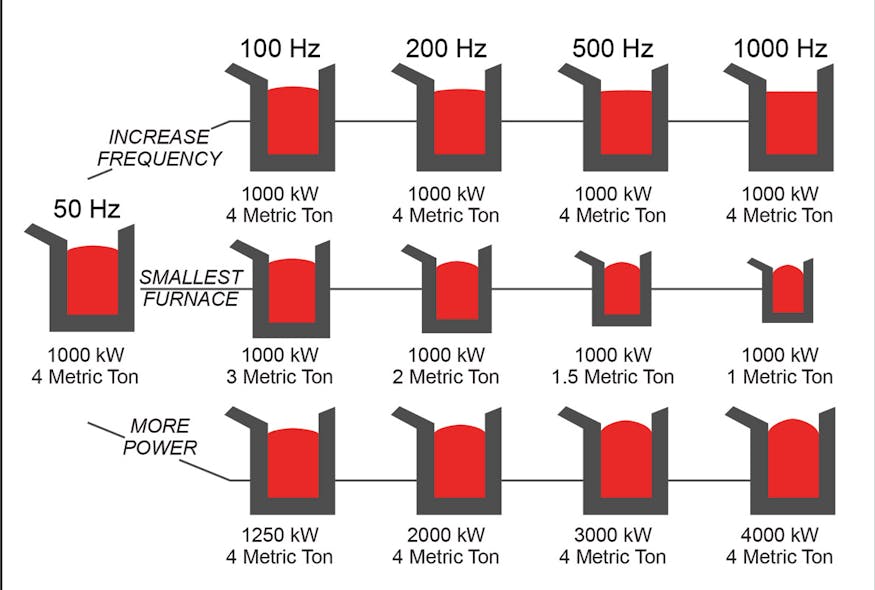

Metal stirring in a coreless induction furnace had been little understood until research undertaken at Inductotherm in the mid-1970s established the science behind the stirring forces. Up until that time it had been thought that inductive stirring in an induction furnace was related linearly to the meniscus height in the furnace. This linear relationship is described in Figure 1.

Meniscus height varies directly with kilowatts and inversely with the square root of frequency. However, in actual melting operations it became apparent that this simplistic approach was not an accurate measure of stirring. Furnaces containing the same amount of the same metal, but running at different frequencies, did not stir the same even though the meniscus heights were identical.

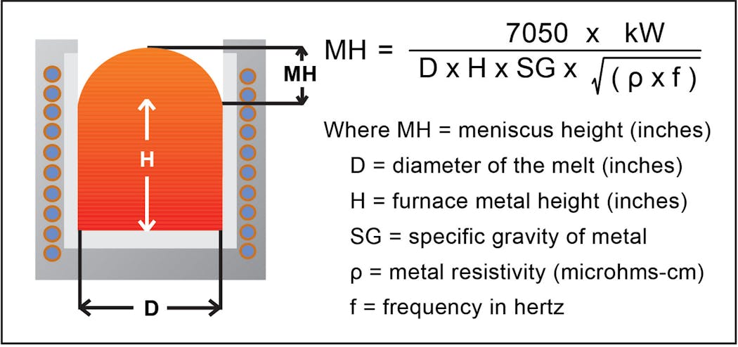

It was found that meniscus height is caused by the interaction of the magnetic field from the induction coil and the current that is flowing in
Figure 4.
the molten metal. This force is equal to the vector product of the magnetic flux density and the current density of the melt (JxB), and is applied to the circumference of the melt.
This force acting on the circumference of the
Figure 5.
melt squeezes the fluid, causing some of the fluid to pull away from the wall and rise up (see Fig. 3). As both J and B are proportional to the current flowing through the coil, the meniscus height is proportional to the current flowing through the coil squared.
As kW = I²R, where R is the resistance of the coil and the melt, the meniscus height is proportional to the kilowatts applied to the furnace and inversely proportional to the resistance of the furnace coil and the melt.

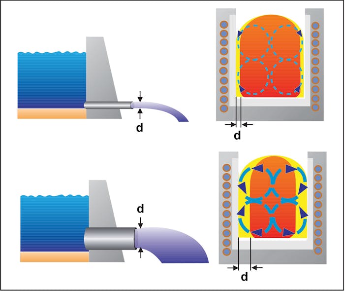

Meniscus height (MH) represents the potential energy of the melt in the same way that the height of water in a reservoir (WH) represents the potential water energy/pressure in that reservoir (see Fig. 4).
In the furnace, the flow of metal is accelerated only when current is flowing in the melt. Thus, the accelerated flow only occurs in the region defined as the depth of current penetration. This depth of penetration is equated to the size of a pipe connected to a reservoir. A large depth of current penetration would be a large pipe and a very small depth of current penetration would be a very small pipe (see Fig. 5).
Figure 7.
Obviously, for the same meniscus height (pressure of water available), the larger the depth of current penetration (the larger the diameter of pipe), the greater will be the flow (of water).

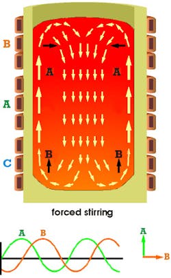

Traveling Electromagnetic Wave Stirring — Traveling magnetic waves always require implementation of multiple coils and phase shifting between currents flowing in each coil. Similar to an asynchronous induction motor, the multi-phase furnace forces metal in the
Figure 13.
sleeve along the furnace wall to move in one direction, thus creating uni-directional stirring. Changing the sequence of phases changes the direction of molten metal flow.

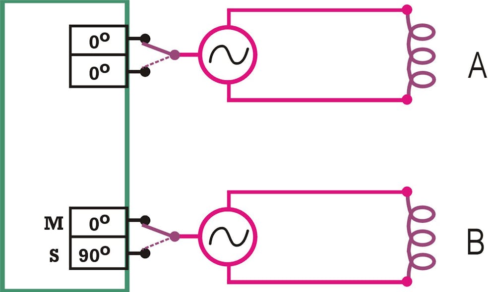

Uni-directional stirring is implemented by applying two-phase current shifted by 90° for each coil (see Fig. 8). Three-phase current shifted 120° apart or four-phase current also is possible.

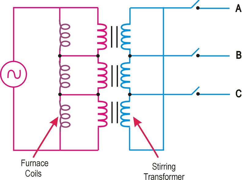

1. One melting and one three-phase stirring source may be connected to one three--section coil as shown in Figure 9. This scheme uses a single medium-frequency inverter for heating/melting and a three--phase line frequency transformer for stirring.

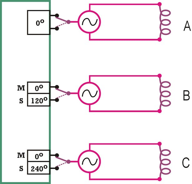

2. A three-phase inverter connected to a three-section coil is shown in Figure 10. The inverter outputs may operate with the control in one-phase for melting or in three-phase for stirring. In the Melting Mode, current in all coils have the same phase. In the Stirring Mode, current in coils B and C are shifted 120° and 240°, accordingly. This scheme is more reliable than others because it does not require large current switches to change from melt to uni-directional stir or vice versa.
3. A two-phase inverter, shown in Figure 11, with phase shift of 0 to 90° can also produce uni-directional stirring. Although the intensity of the stirring is 25% less than three-phase uni-directional stirring, it is sufficient to produce continuous uni--directional flow. The direction of the flow may be reversed when the phase of the second inverter is changed from +90° to -90°.

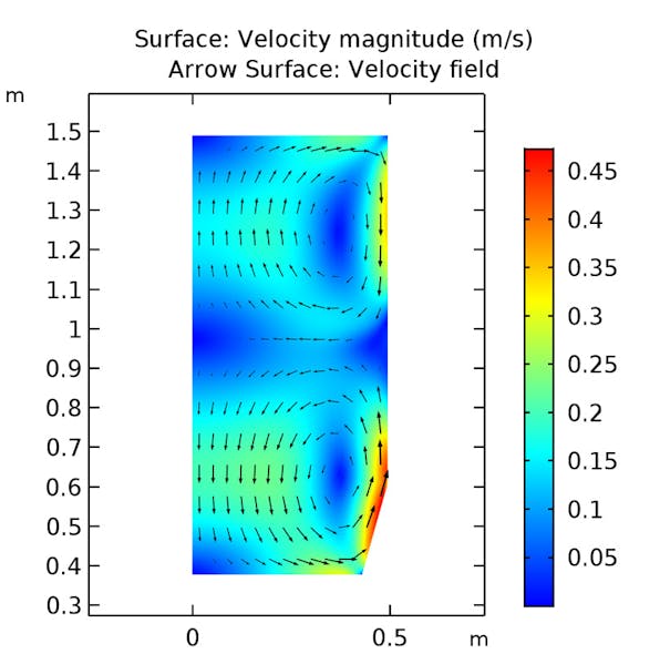

Simulation Technology
Modern computer technology allows modeling of the distribution of the electromagnetic fields and magneto-hydrodynamic processes in induction furnaces. The results of this modeling show the pattern of metal movement.
Figure 12 shows a typical computer simulation of metal stirring in a standard induction melting furnace. Figure 13 shows metal movement in the same furnace with a two-phase inverter inducing uni-directional stirring.

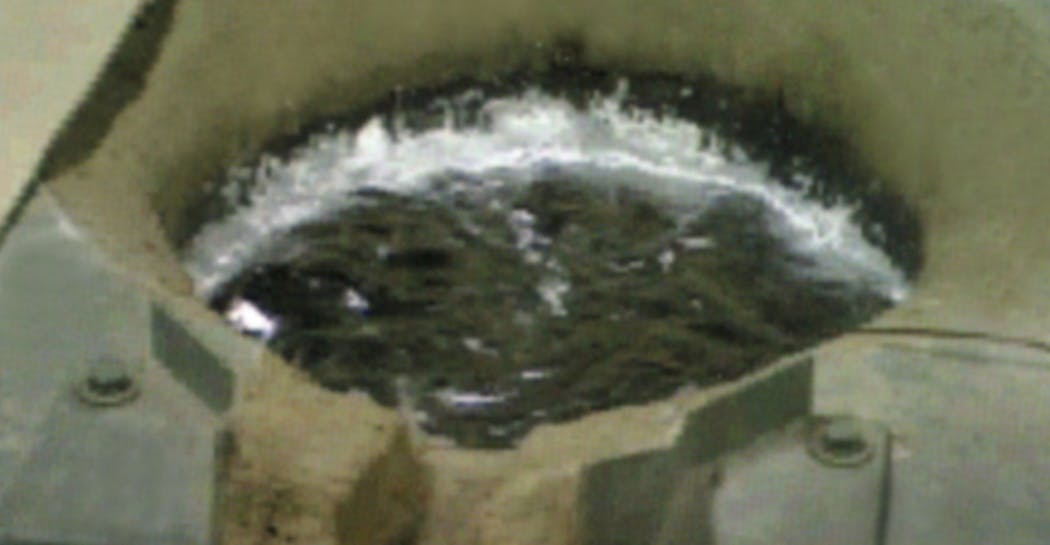

Figure 14 shows the metal surface of a zinc melting furnace operating in two-phase reverse stirring mode. It clearly shows strands of metal coming up the walls of the crucible and coming down the center of the bath, forming a funnel. When metal chips of light material such as aluminum are added to the molten bath they are quickly siphoned into the bath and dissolved.
