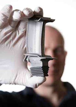

Rolls-Royce’s new Advanced Blade Casting Facility in Rotherham, England, manufacturers two types of single-crystal turbine blades: high-pressure (HP) and intermediate-pressure (IP). Each blade has a series of precisely placed holes, for air cooling, and finished blades are coated with a heat-resistant ceramic.

Investment casting is critical to achieving the structural integrity necessary for the engines’ turbine blades. The turbine draws energy from a hot gas stream delivered by the engine’s combustor, and uses that energy to power the fan and the compressors. The blades to be produced at the ABCF will perform at temperatures up to 200°C above the melting point of their alloy, Rolls-Royce detailed, rotating at more than 12,000 rpm. In that process, each blade is subjected to more than 12 tons of centrifugal force.
Investment-cast turbine blades are formed by filling a permanent mold with wax, then using the wax models to form ceramic molds. When the molds are set the wax is evaporated, and the cavities are filled with nickel-based superalloy.
The critical aspect of investment casting for turbine blades is the directional solidification process, in this case single-crystal solidification. The molds filled with the molten super alloy are placed in a vacuum induction melting furnace so that each blade can form around a single crystal.
Rolls noted that two types of single-crystal turbine blades are manufactured at Rotherham: high pressure (HP) and intermediate pressure (IP).
Each Trent XWB engine includes 182 turbine blades. Each blade is approximately 10 cm high and weighs 300 g. There are about 200 steps of production for each blade before it is ready to be installed in an engine.
