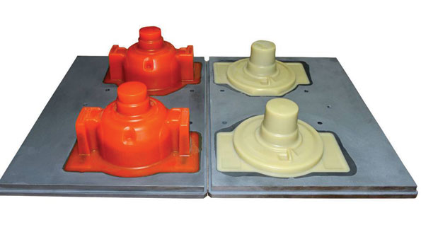

Pattern plates produced with RakuTool PC3458 PH3958 left and RakuTool PC3459 PH3958 right

To manufacture a pattern plate, the first step is to make an original model or prototype pattern plate. This is then used to create a negative. After that, an undersized backing is produced for face casting. This backing may be made of a wide range of materials such as wood, plastic or metal. “The key criterion used to select the material for the backing is the quality that needs to be achieved in terms of stability and dimensional stability,” according to Marcus Vohrer, head of application engineering at Rampf Tooling Solutions. The finished backing and the negative are assembled in the correct dimensions.

The Raku-Tool® PC-3458 / PH-3958 face casting system uses a highly abrasion-resistant material that the developer claimed has already been used to produce over 200,000 parts. It can be poured manually in quantities of up to 25 kilograms, and cures for use the following day. It reportedly is the only commercially available system with a heat-deflection temperature (HDT-B) of 95°C, which promotes higher process temperatures and thereby increases production capacity over the long term.
Thanks to the high number of parts the systems is able to produce, it is particularly well suited to large-volume series production of coreboxes and pattern plates. Advantages include the material’s “exceptional” dimensional stability; dimensional accuracy for the foundry equipment (metal backing); high chemical resistance; swelling prevention; and minimal (or no) sand adhesion. The system also reduces maintenance costs, as only the face-casting layer needs to be renewed once the wear limit is reached.
Rampf claims that over 80,000 parts have been produced using the Raku-Tool PC-3459 / PH-3958 face casting system. The beige-colored formula is ready for use after curing at room temperature for five to seven days. Raku-Tool PC-3459 / PH-3958 has an HDT-B of 65°C and can be poured manually in quantities of up to approx. 110 kg.
