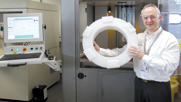

Even more recently, Cti was approached by a multinational manufacturer to help it replace some critical spares after component failures began to impact its production. It took Cti just three weeks to reverse engineer the part using high-strength steel and manufacture 72 precision-engineered castings. Following some customary, and extensive, quality control procedures the first batch was delivered to replenish the plant’s depleted stocks.
“We worked evenings, Saturdays, and Sundays, as appropriate, to mitigate the client’s losses. It exemplifies our ability and willingness to deliver complex castings in a fraction of the lead-time required by traditional foundries when a client hits trouble,” explained Richard Gould, commercial manager at Cti, which is a constituent of the University of Sheffield Advanced Manufacturing Research Centre with Boeing, at Catcliffe, England.
Complexity in fraction of time
Cti worked from a damaged component removed from failed equipment. Research specialists from Cti’s laboratory and testing division used spectroanalysis to identify the material from which the original component had been made, and laser scanning technology to take measurements. These details were fed into a computer-aided design program to create a 3D CAD model.
Cti designers used the 3D CAD model to produce drawings of an undamaged component and process modeling techniques to add a feeding system, creating a pattern for a mold that would fill with molten metal at the optimum rate to make perfect castings.
In an effort to ensure minimal risk and delivery in the shortest possible lead-time, two batches were launched (each with marginally differing shrinkage rates applied) down each of two different process routes (i.e., four batches in total.)
Data from the CAD drawing was fed into Cti’s additive manufacturing operation, which uses stereolithography to make replica patterns out of epoxy resin or molds out of sand. The resin system incorporates a laser that traces the shape of the component in a bath of resin, becoming solid where the light strikes it, while the additive mold system binds sand together utilizing a highly specialized chemical process.
Then, Cti used Replicast to manufacture two batches of the components. Each epoxy resin replica was dipped into a tank filled with a slurry of ceramic material, to create a shell with the requisite surface finish. (In the case of sand printing, the molten metal is poured directly into the mold.)
Proceeding with the Replicast process, the ceramic shells are fired, removing the epoxy; put into casting boxes, and surrounded with refractory sand. The boxes are shaken on a vibrating table. Air is drawn out of the sand to create a firm support for the shell, before molten metal is poured into it.
