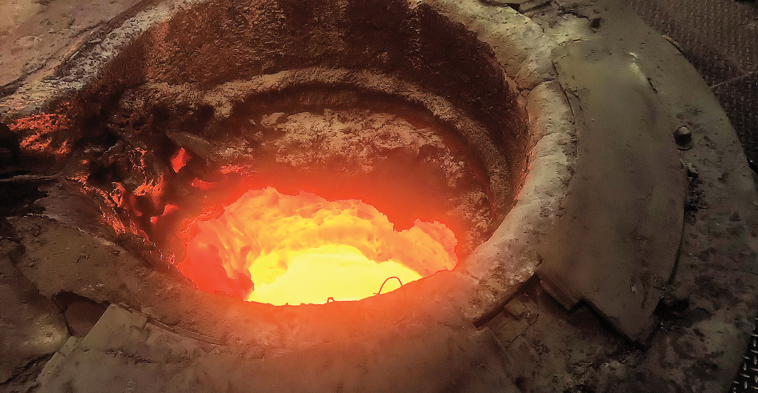

Typical slag build-up in a coreless induction furnace.

In a coreless induction furnace, insoluble slag residuals can deposit along the refractory walls within or slightly above the active power coil (see Figure 1, above.)
Because these oxides and non-metallics are not soluble in molten metal, they become entrained and float in the molten metal as an emulsion. When emulsion flotation effects become great enough, non-metallics rise to the surface of the molten metal and agglomerate as a slag. Once the non-metallics coalesce into a floating mass on the liquid metal they can be removed. A suitable fluoride-free flux such as Redux EF40 will accelerate this flotation process.
When slag contacts a refractory wall that is colder than the melting point of the slag, this will promote the slag to adhere to the lining. The adhering material is called build-up. High melting-point slags are especially prone to promoting build-up. If not prevented from forming or not removed early during formation, build-up will reduce the overall efficiency and capacity of the furnace.
