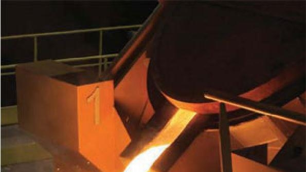

One appeal of a greenfield development is that there is no need to compromise. The equipment selections represent Brembo's ideal for metalcasting. Melting is done a series of coreless, mediumfrequency furnaces, chosen mainly due to the competitive cost of electricity in Poland, and the flexibility for batch production that induction melting allows. Another factor was the reduced environmental impact of induction melting.

Gray iron pouring is carried out by a pressurized pouring furnace, with laser controls to maintain a constant level of liquid metal in the launder; cameras are used to check molten iron levels in the sprue cups as pouring proceeds. These devices will reset the signal for the stopper rods in order to adjust their position. Sensors maintain iron temperature through the pouring stream of every cycle, Brembo noted.
