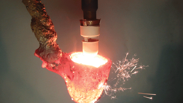

The SinterCast CGI process involves a proprietary sampling cup that the developer calls ldquothe most accurate thermal analysis device in the worldrdquo The design represents five patents and the group holds seven more patents related to solidification behavior and thermal analysis
