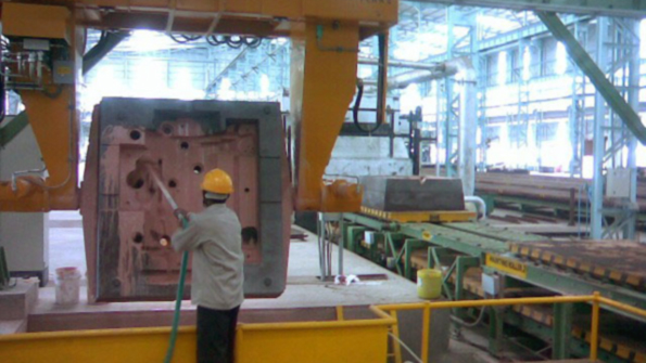

SOLITEC™ DI is a mold coating solution that also functions as an indicator of the drying status, thereby supporting in-process quality assurance efforts. It’s a water-based solution that changes color during drying, providing an easily discernible, optical indication of its drying status.

Complete drying of the coating layer is absolutely essential to avoid casting defects such as blisters, gas and slag inclusions, porosity, or a rough surface finish. Although insufficient drying will lead to rejection and incurs reworking costs, excessive drying often entails higher energy costs. Both situations result in loss of productivity and reduced efficiency.
As yet, there is no simple analytical method for metalcasters to determine a coating’s degree of dryness. However, this problem is addressed by SOLITEC DI. The water-based coating changes color when drying, acting as a wet/dry indicator, and in that way a previously unavailable tool for foundries to promote productivity and product quality.  The visual confirmation of the drying state makes SOLITEC DI an exceptional quality assurance instrument.
If sand molds or cores exhibit soft areas due to inadequate compaction, i.e. loose areas with low density, these will tend to absorb more moisture from the coating than the surrounding areas, which means they take longer to dry. Here, the clearly discernible color change supports higher productivity, and optimizes quality for cores and molds. Problem cores and molds are recognized easily and spoiled castings can be avoided before even greater investment outlay is incurred.
