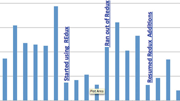

Prior to using Redux, total casting scrap due to slag had been running close to 1.26% on average, in spite of using filters on almost every casting. Switching alternately from ceramic foam to pressed, then to extruded filters showed no reduction in scrap rates associated with “dross or slag”.
In mid-September 2012, Foundry A started by adding just 1 lb. of Redux per ton of metal to every five-ton ladle, and quickly found the incidence of defects associated with slag dropped to roughly 0.43%, a 65% reduction.  In mid-October, Foundry A ran out of flux, and almost immediately casting scrap increased dramatically to pre-flux levels.  Upon re-ordering flux and adding it at the same 5 lb. of flux to each and every five-ton ladle, scrap rates associated with slag plummeted again.  The reduction in slag-related casting scrap that Foundry A achieved after five months of using Redux is shown in Figure 1.
Figure 1: Charting one foundry’s significant results by adding an alkaline-based flux on reducing inclusion defects.
Foundry A continues to add flux to every ladle on a daily basis, and has realized an estimated annual savings of over $500,000 per year. During calendar year 2013, overall slag defects averaged 0.38% of total production and Foundry A is continuing to make improvements in its melting and metal handling systems to reduce slag-related defects even further.
