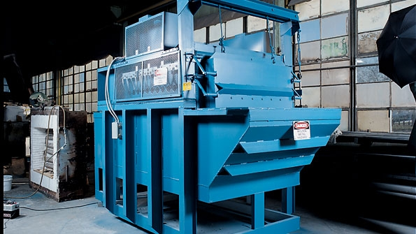

The Schaefer Group Inc offers its electric immersionelement holding furnace as an opportunity to acheve energy savings in aluminum melting with ROI in less than three years

Electric Immersion Melting and Holding Furnaces
The latest option in electric melting is the immersion element furnace. They originated in Japan over 15 years ago but became popular in the U.S. about 10 years ago. There have been numerous improvements to the original design. By using a dense, castable hot face and a micro-porous silica, back-up super-insulated lining you can achieve excellent energy efficiency from these furnaces, for example, with metal at 1,250°F, casting temperatures are as low as 105°F.
Radiant tubes in an immersion furnace.
The new, electric immersion-element holding furnace uses elements within sialon tubes in the middle of the aluminum bath. This produces no thermal head temperatures, which means less metal loss, less oxide growth, less dross, excellent bath temperature uniformity, and a casing temperature of less than 110° F. In addition, the furnace will hold aluminum at temperature (1,250° F) for less than 18 BTUs/lb, with well covers on, and less than 22 BTUs/lb in production. This compares to 35-40 BTUs/lb in a conventional radiant-roof electric holding furnace.
On average, they achieve two years of service life on the elements and over five years of service life for the tubes. You can change the elements on the fly and can stay hot with one element untill the other one gets changed. The 2,000-lb units have 25 kW connected, 4,400-lb units have 35 kW connected, and the 9,000-lb units have 90 kW connected. All of our immersion element furnaces have additional power connected in case you need a passing gear. Because these units have full proportional controls you use only what you need to maintain temperature, saving more energy than “on-off” designs.
