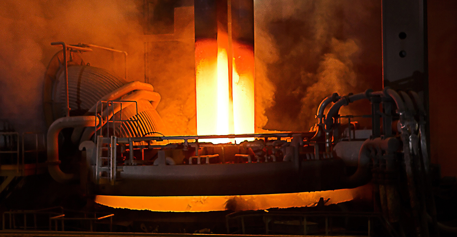

Electric arc melting is used to produce steel from scrap, in particular for structural castings.

The electric furnace was designed and built in the 1960s to melt and tap up to 90 metric tons, and later modernized to a 150-mt capacity. Over seven months, it was largely rebuilt, with a new furnace gantry, electrode columns and current-carrying arms, cabling, and new automation, process control, hydraulics, and water-cooling systems, to achieve a 15% improvement in performance efficiency.
