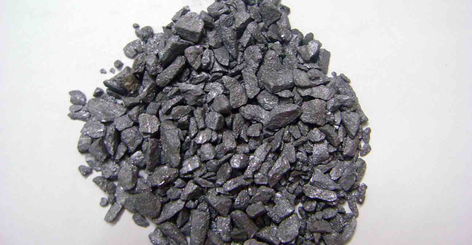

Using this concept, patented technology (U.S. Patent 6,293,988B) has been developed and is based on a ferrosilicon-free inoculant, mechanically blended alloy that contains high levels of calcium and stoichiometric amounts of sulfur and oxygen, similar to the Naro and Wallace research findings. Using proprietary blending techniques, this new alloy has demonstrated remarkable abilities to reduce shrinkage, improve inoculation (reduced chill, elimination of carbides) improve nodule count and nodule shape.
Alternate methods to introduce sulfur and oxides onto the surface of a cerium/calcium containing ferrosilicon based inoculant is limited to the amount of these materials than can be coated onto the surface of the ferrosilicon particle substrate, thereby limiting the critical amounts of sulfur and oxygen needed to boost inoculant potency. Late additions of sulfur and oxygen allow the other proprietary inoculating elements (calcium, aluminum, barium, et. al) to react in situ, and provide multiple times the nucleation sites of other, less potent inoculants.
Sphere-o-Dox (SOD) has shown remarkable abilities to solve many troublesome inoculation situations. SOD is a proprietary blend of oxy-sulfide forming elements that provide a high volume of graphite forming nuclei when added to molten gray or ductile irons. Not only has it replaced high-potency rare earth-containing inoculants at numerous foundries, but it can be used as an inoculant enhancer to improve the performance of all ferrosilicon-based inoculants, such as standard calcium-bearing, barium-bearing or rare-earth containing alloys. As a result, greater efficiencies during inoculation treatment have been obtained at significantly lower addition rates, in both grey iron and ductile irons, resulting in significant metal treatment cost savings.
