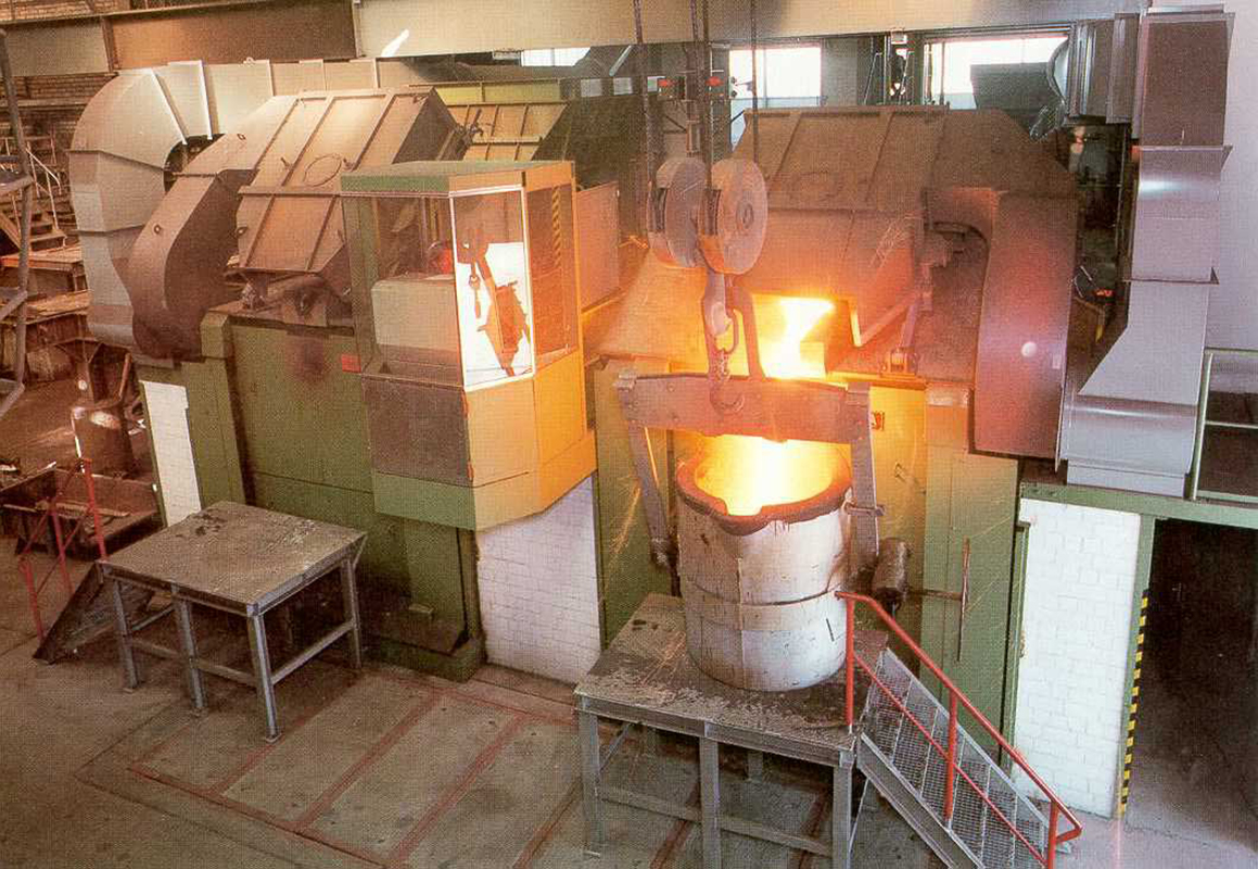

A coreless induction furnace is essentially a refractory-lined vessel surrounded by an electrically energized, current-carrying, water-cooled copper coil. Electrical current in the coil induces an electromagnetic field, which magnetically "couples" with the magnetic charge, producing electrical current within the charge itself. Each piece of metallic charge has its own internal resistance that, when energized by these internal currents, will heat up and eventually melt. The resulting magnetic field in the molten metal causes a stirring action, thus ensuring a homogenous liquid mass.
In all coreless induction furnaces, there is an “ideal” refractory wall thickness, carefully calculated by the furnace manufacturers for optimal melting performance. This calculation includes safety considerations, electrical characteristics of the coil, metallic charge resistance / electrical conductivity, structural and refractory considerations, operational constraints and production needs. When the furnace melt diameter is reduced by buildup, the melting process efficiency becomes compromised. The result is a reduction in the percent power utilization and energy consumption increases.

Generally, adding fluxes ensures that slags have a melting point below the coldest temperature in the system. Fluxes can help control slag and other insolubles from freezing on the cooler refractory surfaces. Adding flux allows for the flotation of the emulsified oxides and sulfides; it also may reduce the melting point of the slag to below the lowest temperature encountered in the melting furnace and associated liquid metal handling system. An example of severe buildup in a coreless furnace is shown in Figure 2.

The following example illustrates how flux additions can improve melting efficiency. Foundry G is a medium-sized gray-iron foundry. Historically it experienced extensive slag buildup on the upper sidewalls of its four three-ton medium-frequency coreless induction furnaces, in a semi-batch melting operation. With a newly installed silica lining, melting capacity is 1,525 tons/month with two furnaces running five days/week, 21 days/month.
Foundry G’s charge consisted of 100% metallic fines and machining chips. Each coreless furnace is lined with a silica-based dry vibratable refractory. During melting, slag generation and residual buildup immediately reduced furnace capacity and contributed to increased melting time and increased power consumption. After 48 hours of operation, three inches of an iron oxide, silicate-rich buildup occurred along the entire sidewall (see Figure 3.)
Foundry G initially incorporated two pounds of Redux EF40L flux per ton of metallic charge, added to each back-charge to determine its effect on buildup. EF40L was added to the furnace before back-charging on top of existing molten metal to ensure excellent mixing, (a minimum 50% molten metal bath.) Immediate improvements were observed and buildup along the sidewalls essentially was eliminated. Because optimal refractory thickness was maintained, it is estimated that the power utilization increased by 25% compared to pre-buildup days.
