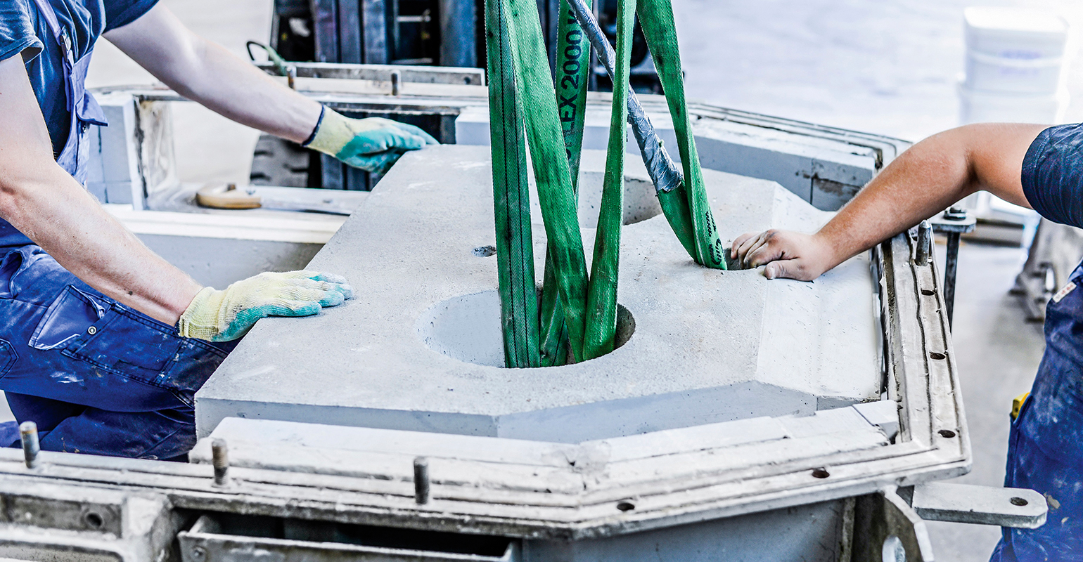

Precast and pre-sintered refractory parts expedited the repair and return to service for Fémalk Zrt.’s aluminum dosing furnace.

StrikoWestofen also refurbished two Westomat dosing furnaces with OEM parts rather than third-party alternatives, an approach that has been proven to reduce energy consumption by up to 50%. The developer has defined a dosing furnace relining service program that uses high-quality, precast (and pre-sintered) refractory parts; as well as improving insulation and thereby energy consumption, this approach also means relining can be carried out much more quickly. Because the precast refractory parts are pre-sintered, the heating process is accelerated once work on the furnace lining is rebuilt.
“We completed relining work on the Westomat in less than two weeks, ensuring minimal disruption for the customer. At a time when energy costs are so high, the savings generated, combined with the performance improvements delivered for the StrikoMelter, will mean that Fémalk to reduce operational costs and optimize ROI on their equipment,” StrikoWestofen vice president Holger Stephan explained.
