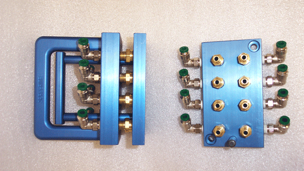

INDUSTRIAL INNOVATIONS reports that its Quick Spray Release multi-connection manifold allows “one-click” disconnect and connect of multiple hoses, to assist with Quick Die Change.  This simplified method eliminates costly set-up time and confusing lube line hookup, to ensure lubricant spray is applied where intended every time.
In traditional die change procedures, operators disconnect and then connect all hoses individually, slowing or complicating quick die-change efforts.  Additionally, there is a greater chance for error as the operator may mismatch hoses and nozzles to deliver the wrong amount of lubricant, to the wrong place, at the wrong time.
With Industrial Innovation’s one-click, spray nozzle multi-connection design, each die has hoses connected to a single standard manifold. During die changeover, the operator simply unclicks the quick-disconnect manifold, and removes the die.  The new die is then put in place and the new manifold plugged in.  The operator then loads the part program and spray profile for accurate volume, placement, and timing of the lubricant.
