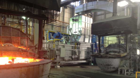

StrikoWestofen installed a new StrikoMelter furnace for Inzi Amt in South Korea allowing the automotive aluminum diecaster to reduce its energy consumption from more than 120 m3 of natural gas per metric ton of molten aluminum to less than 60 m

The potential for operating cost savings also was the decisive factor for Inzi Amt, an automotive caster in Dangjin. Like Il Gangh, Inzi Amt manufactures diecast parts, including gear housings and cylinder heads. It replaced a locally built furnace with a StrikoMelter system, and besides achieving a considerable increase in process reliability, the new system approximately halves the energy consumption.
The energy consumption of 120 m³ of natural gas per metric ton of molten aluminum has been reduced to a nominal consumption of less than 60 m³ of natural gas per metric ton, according to the furnace builder. The improved efficiency also is evident by the reduction metal loss made possible by the EtaMax shaft geometry.
