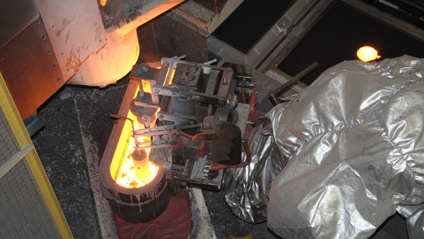

Two Kuka Robotics KR 1000 Titan robots are able to maximize the task of filling sand molds with ductile iron with minimal waste and optimal efficiency

Kuka Robotics devised a system with two KR 1000 Titan robots for casting the molten iron, allowing the foundry to gain the flexibility to maximize the mold area for greater pouring efficiency. The two robots work in parallel in a solution developed by robotics system integrator Robotec Engineering GmbH. The pouring system no longer dictates where the mold can be positioned.
A heat-resistant shroud protects them against the foundry workplace conditions. Mounted on the robot flange is a casting ladle filled with 1,400°C iron. A load cell is installed between the casting ladle and the robot flange, to weigh the quantity of molten iron, and ensure the precise volume of iron required to make up the correct portion for the next casting cycle. Only the optimal volume of metal is measured into the casting ladle – which ensures waste is minimal.
The flexibility of the six-axis Kuka robots means that iron can be poured into the mold at any point. Once the molds are filled and the castings are formed and cooled to room temperature, the parts are cleaned, inspected, and prepared for shipment.
Kuka noted that if there are malfunctions or lengthy downtimes in the process, Robotec has developed a method for avoiding metal being held, possibly to solidify in the ladle. The two robots are able to return process iron to the casting furnace. (This contributes to energy savings and logistics costs, but also limits the risk of excess CO2 emissions, Kuka noted.)
Another innovation is fully automatic casting ladle changing – the robot can put down the used casting ladle and pick up a new one, just like a robot gripper change, according to Kuka. The robots also are available for various setup tasks on the pouring aisle.
