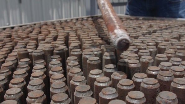

The plain tube carbon steel Thermosyphon Heat Pipe units have an inherently low fouling factor and are easy to remove clean and reinstall

Aluminum foundry case study — A gas-to-air cross-flow heat-pipe heat exchanger was installed at an automotive casting plant in July 2005. In July 2013, a complete inspection of the system was conducted to evaluate its condition and the performance of the heat pipes, as well as the condition of the collection and return systems. The heat pipes in the evaporative section of the heat exchanger contained a fine coating of ash; after wire brushing, the ash was removed and there was no noticeable degradation in the condition of the pipe. In the condensing section of the HPHE, the color and condition of the pipes were as-new. There was a slight build-up of particulate in the condensing section due to combustion air being drawn from within the foundry.  Three pipes were removed and lab tested, and performed as well as newly manufactured pipes with an efficiency loss <2% from the date the 2005 installation.

3. The plain tube, carbon steel HP units have an inherently low fouling factor, and are easy to remove, clean, and reinstall. (See Figure 3.)
