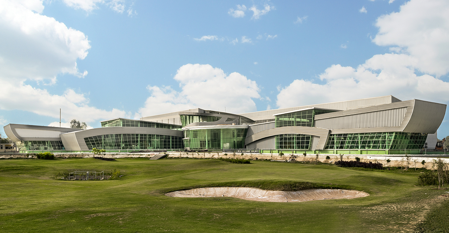

Recently, British foundry R&D center Castings Technology International (Cti) helped PTC Industries to start up the first titanium casting plant in India, based on Cti’s Replicast® process. Replicast involves using patterns formed in polystyrene and dipped in a ceramic slurry, and then fired to form a ceramic shell that establishes the mold for casting metal.
PTC established the titanium foundry at its Advanced Manufacturing Technology Centre in Lucknow, in response to domestic and foreign customer demand, and with support from the Indian government’s ‘Make in India’ campaign.
The new foundry will produce high-integrity castings for safety-critical applications, including valves for U.S. and European oil-and-gas projects.
