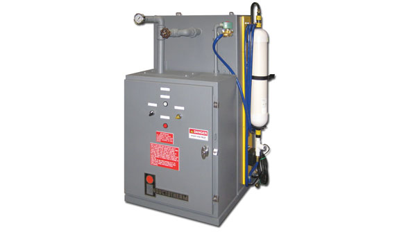

The DACXtreme system is recommended for induction furnace systems operating in moderately hot climates and consists of a dry air cooler and trim system

Reducing water consumption in moderately hot climates
Inductotherm Corp.’s DACXtreme system is recommended for metalcasters in moderately hot climates. It consists of a standard dry air cooler with a fog trim system (FTS) and a demineralized water storage tank. When the temperature begins to rise above the standard dry air cooler’s limitation, a temperature sensor activates the FTS to release a demineralized misting spray. As the demineralized water evaporates in the air around and on the surface of the tubes, heat is removed, effectively lowering the local ambient temperature around the cooler.
It is important that the water used is demineralized so the dry air cooler does not get plated with minerals, which would insulate the cooler tubes and create a self-degrading system where more external water is required to maintain proper cooling.
During hot weather, the expected water consumption is 2.5 gallons per minute per 1,000 kW, compared to 6.0 gallons (average evaporation and bleed) per minute per 1,000 kW year-round for a standard industrial tower. The DACXtreme system offers many of the cost advantages of a dry air cooler with some additional cooling associated with an evaporative system.
