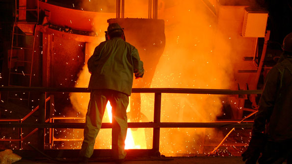

Monitoring steel casting at Bradken Engineered Products division Amite LA
