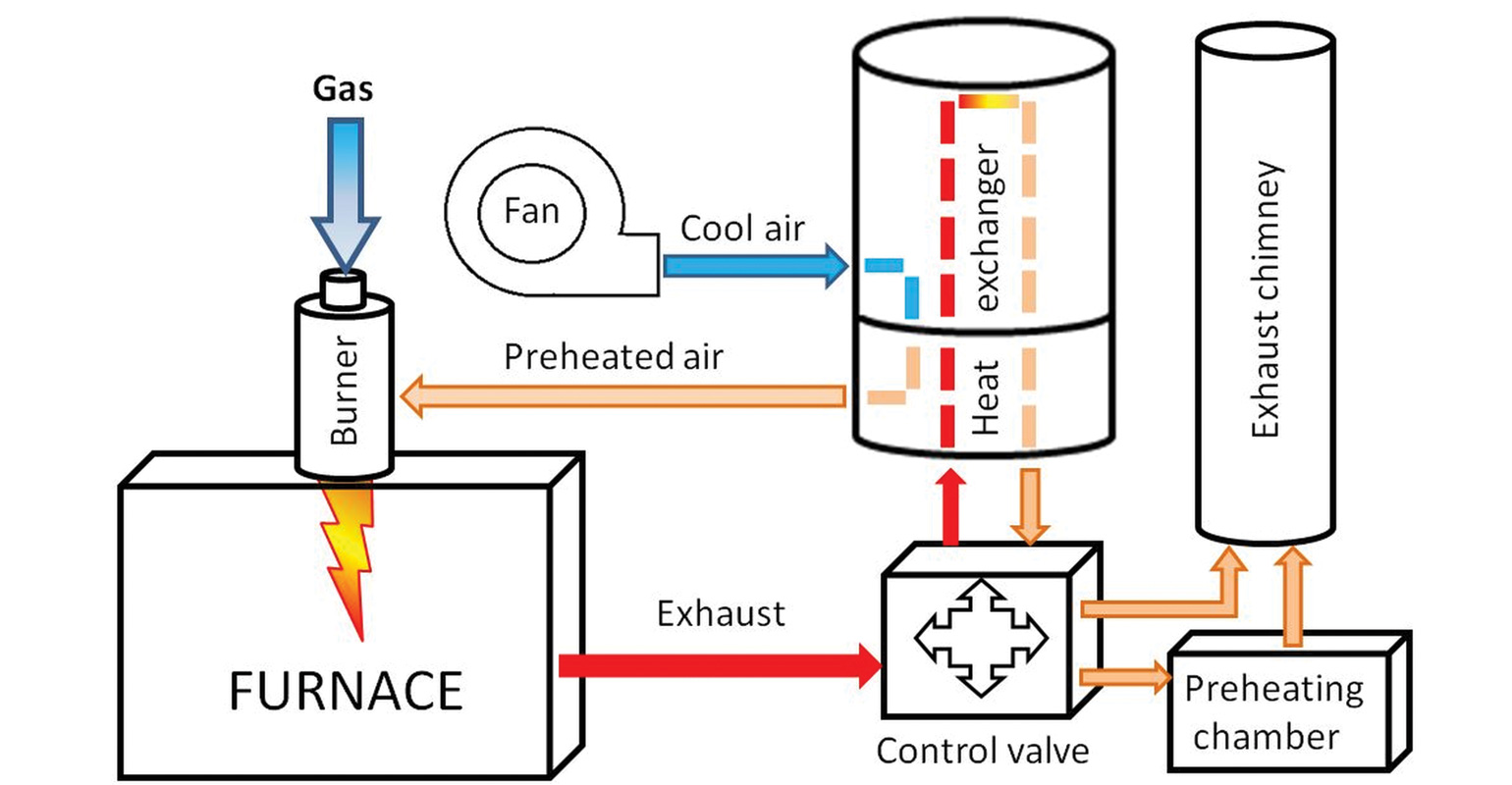

In burner air preheating by means of a heat exchanger, the warm exhaust-gas volume flow is directed via a suitable pipe system to a heat exchanger. This saves on gas consumption.

"With this version, the already heated exhaust-gas flow is directed to a heat exchanger via a suitable pipe system," Sauke continued.
Handling gas carefully — The primary air (hot gas) side of the system, which is prefixed to the heat exchanger, requires additional components. For example, a control unit that directs the exhaust-gas flow to the heat exchanger as required, and additional measuring points that ensure safe process management.
In the event of failure of the heat exchanger or any of the components, the control unit must direct the exhaust flow through a bypass function, past the heat exchanger, directly into the secondary system to protect the heat exchanger and its components. In the heat exchanger, the energy is released to the secondary air (burner air) side; the cooled exhaust gas is discharged in the other system either directly into the atmosphere, or to preheat the furnace charge material in a corresponding chamber.
The burner-air fan conveys cold burner air from the environment into the heat exchanger, which is heated there in the ZPF melting system to about 200° C. The pipe system after the heat exchanger is insulated and equipped with appropriate butterfly valves, measuring instruments and displays. An air collector installed directly after the heat exchanger helps distribute the heated medium evenly across the piping to the entire burner system. Thus, the flame temperature increases significantly, resulting in a higher energy input and lower gas consumption.
